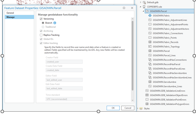

all my layers and tables are versioned.

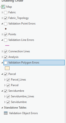

This is how are arranged
these are the layers how i am publishing them. my user has assigned a parcel fabric license, I have a ArcGIs Enterprise 11.1, ArcGIS Pro 3.1.4, SQL Server 2019
What can be happening? I have done several services before and I was able to do it but now, those options for publishing does not appear. Any Idea

DiegoLlamasOlivares
Hello Ken,
Yes it gives me this version error for all my layers, besides dataset i have 3 objects layers and one table, and all of them are set to branch version.
I have un version and version all the layers and dataset several times and i continue with the error.

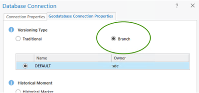

Ah, OK. According to the error, the feature classes are registered as versioned but the connection file is not set to Branch.
00264: Branch versioned dataset, <value>, is not supported from a versioned workspace when the servi...
  • Right click the .sde file and choose Geodatabase Connection Properties
  • There should be an option for Branch versioning. Select Branch
  • Re-add the fabric to the map
