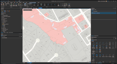

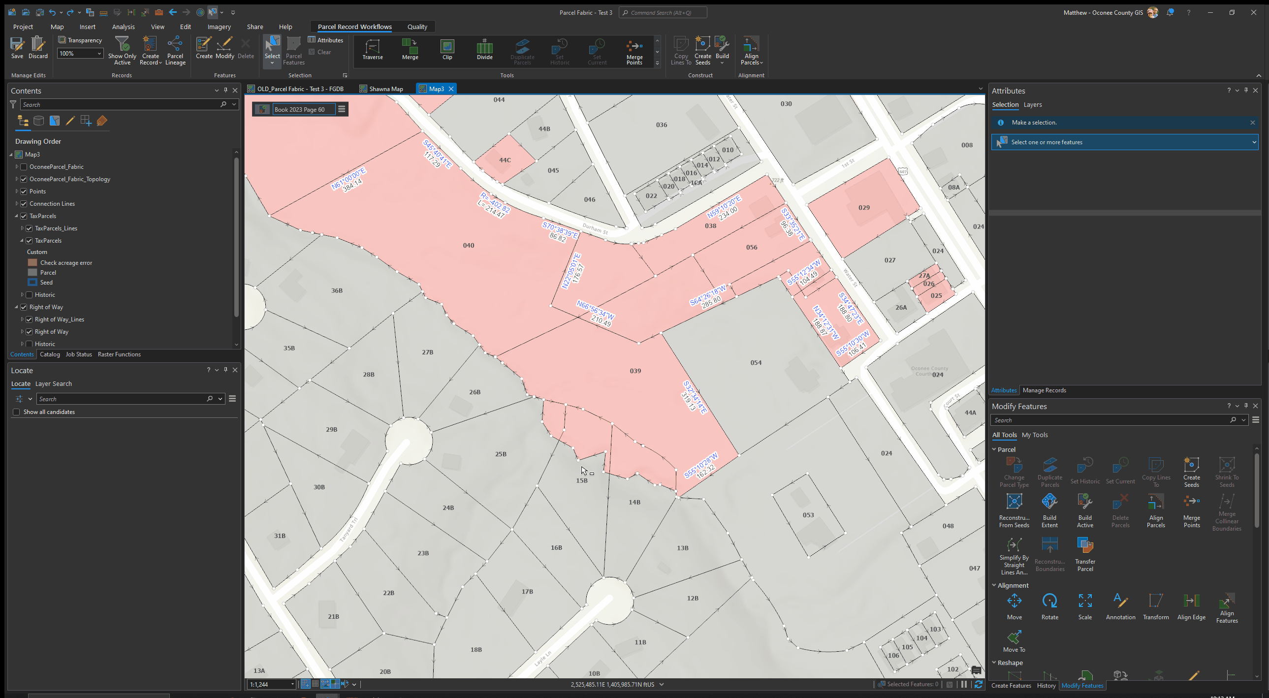

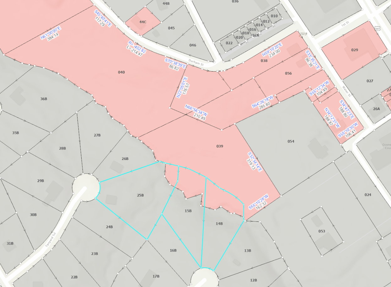

In the image below, parcels 25B, 15B, and 14B (Selected) had a boundary that was just completely incorrect. Not sure where it came from, to be honest, because I have been unable to find a

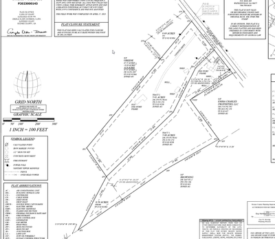

We got a new plat in for surrounding parcels (the red ones with COGO) so I drew those in. Since the boundary was so wildly inaccurate I just figured that I would clip that area out, rather than aligning it since there were far too few points to do so and it was too far away to make the align features point feasible.
After doing the clip, however, the stated area and the area unit of those three parcels was nulled out. Those two fields were set to <Null> for some reason and I can't figure out why. Is this an expected behavior?
I've attached a short gif that showcases the issue. Please let me know if I am missing something. Thank you!

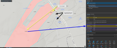

This also happens in cases where a portion of a neighboring parcel is ceded to the current record like in the example below:
After doing the align and clip, the stated area and stated area units was nulled out of TP D 02 023B. This is annoying because I then have to cut on the historic layer to find out what the acreage for that parcel was and then figure out the new acreage.
