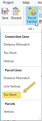

If very small lines are the culprit, we introduced the ability to detect very small lines using a layer in ArcGIS Pro 2.9.
From the quality tab you can add the 'Too Short' layer and view any small lines that should be eliminated.
The Merge Parcel Points tool is a useful tool to use for that process (just make sure to check the option to remove lines in the bottom of the tool)
