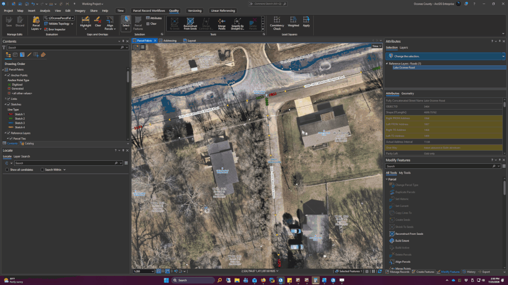

I can't say that I do notice an improvement. It behaves pretty much identically to the previous release. It will usually allow me to move a point once (although it does say "Initializing tool..." briefly. If I try and move another one after that, however, it gets stuck initializing until I kill the program in task manager.
Below is a quick gif of the issue I took this afternoon. Happy to meet over screen share to demo as well if it would be helpful.
Wondering if it could be tied to our portal version? We are currently 11.3 on Portal.
Initializing Tool...Initializing Tool...
