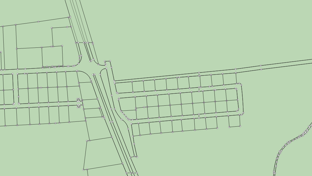

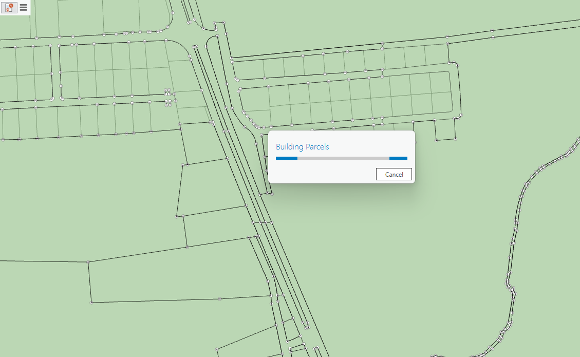

We have a polygon parcel layer. we build a parcel fabric using FGDB and added parcel types. We append polygons and we started to build parcels using build extent. We notice that in some areas, the building process just stays there forever.
and when I cancel it, takes several minutes and cancel the action, but parcels are created

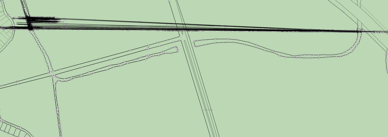

But also it creates this lines and points. and I need to delete them manually or close the program without saving edits and try to build parcels again. so my question is, should i use build parcel fabric geoprosseing tool? i have 78 municipalities some of them have 5k, 10k parcels and others 100k should I use that option instead extent? Regards,

I suspect that you have geometries that are bezier curves. With ArcGIS Pro 3.1 we fixed a performance problem and a geometry problem like the one you show in your third image above. If you are not able to upgrade to ArcGIS Pro 3.1, you could consider converting your bezier curves to circular arcs or to polylines with straight line segments.

Can confirm that this is a bezier curves issue. Had it myself in the past. One area of our parcel dataset had bezier curves in it. I went and manually converted them to true curves, deleted all the extra points and lines that were created, and it completely resolved the issue.
