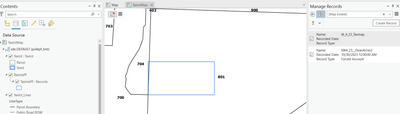

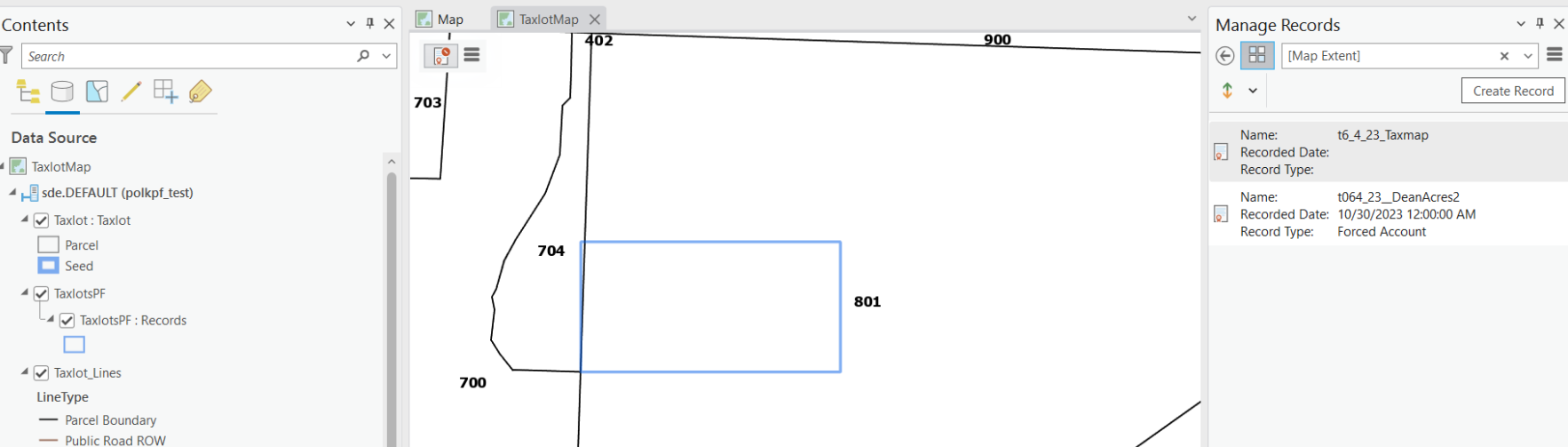

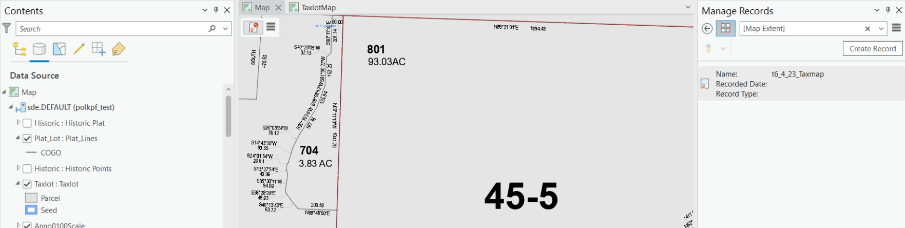

I am using ArcPro 3.2 to access 11.1 Enterprise with Branched Versioning.  I have been having problems with creating a record in a version using procedures posted in(Part 2 - Branch Version with Parcel Fabric) as discussed in my previous post "Problems with Arcp3.2 Parcel Fabric Using ArcPy to Change the Version". I also have a second issue.  In my project,  I  have two maps, one is for general editing and the other for creating a voucher.  Unfortunately when I set both maps to default my second map "retains" the record created previously.   I have tried to refresh the versions with both maps, opening and closing the project files etc.  The following two pictures illustrate my problem. This seems to be independent of my previous problem and just deals with how two maps point at the "default" environment.  My question is --- is anyone else having this issue ?
Map 1:  Set to default.  Only ONE record appears in the map extent.
Map 2: Set to default.  TWO records appear in the map extent.  The second record should NOT be in default.
