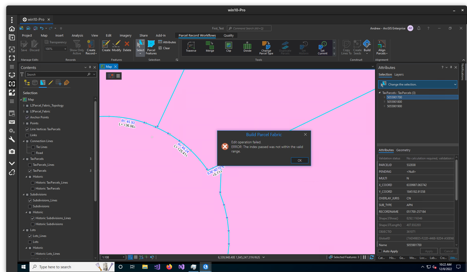

Building the parcel fabric in certain extents has started throwing the error:
Edit operation failed.
ERROR: The index passed was not within the valid range.
Adjacent areas build no problem, it seems to be localized. I tried shrinking the parcels to seeds and reconstructing them but the error persists. Has anyone encountered this? We are using version 5 of the fabric and Pro 3.0.3

@jcarlsonThanks for the suggestion. I logged the event from the Diagnostic monitor but nothing stood out. I don't see any warnings in the log but I do see where the server returned edit operation failed. If I check the ArcGIS Server server logs I see
SEVEREDec 8, 2022, 11:24:24 AMThe index passed was not within the valid range.. HRESULT = 0x80040202Landbase/Landbase.MapServer
