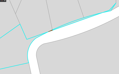

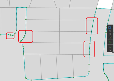

We ran SLACA over a large parcel dataset, upon fabric loading, and have not built up the fabric yet to lines yet.  We only have polygons in this dataset as we are seeking out gaps and overlaps with the highlight tool.  As we scrub the data further, we are noticing several parcels have had their geometries corrupted, to the extent that false curves were created (see screenshots)
In most instances, we've seen the SLACA tool work as advertised in recent meetups from ESRI, but from the screenshot examples, we're seeing an unfortunate influx of parcels that had curves created where there shouldn't be, and curves that fail to be created when they should be, and we just want to know if there is a best-fit array of parameters to have entered to keep this data's geometry as intact as possible while eliminating the densification of curves as the tool is intended to work.

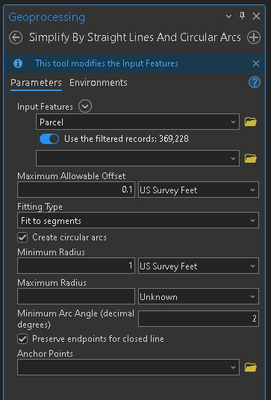

Here is an update, below are the parameters used when I re-loaded these parcel polygons from the source and ran the SLACA in a manner that best output to match the original, while creating arc segments, even for the small radius ones.  It also prevented those straight segments from inadvertently 'eating' into the rectangular unit polygons.  It's the solution I will apply to other areas similar to this, laden with stacked condo parcels and complex road parcels having curves with various radial sizes.  Looks like the key was to have "Fit To Segments" selected over fit to vertices, while having a minimum radius set to 1  (Not sure what the default is if no minimum is entered).  We would have to be careful with this, as it may not be the solution in other areas in the event that it creates small curves where it shouldn't.  Perhaps there is NO one-size fits all set of parameters to apply across the board on a large dataset of all kinds of parcel geometries, ranging from detailed condos to large parcels in remote areas.

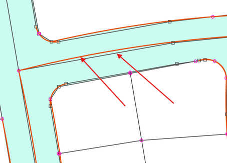

I'm also having this problem while running the SLACA tool. Here you can see the phenomena that the OP is discussing where the tool is creating curved lines in situations where it doesn't need to be curved. On top of that, I'm getting different results between polyline and polygon features that have coincident vertices.

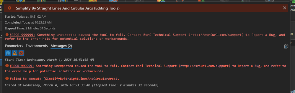

I also very frequently get 999999 errors when I run the tool.
