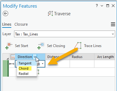

AmirBar-Maor
@NathanDuncan
Upgade to a recent release. You can set it to Chord
