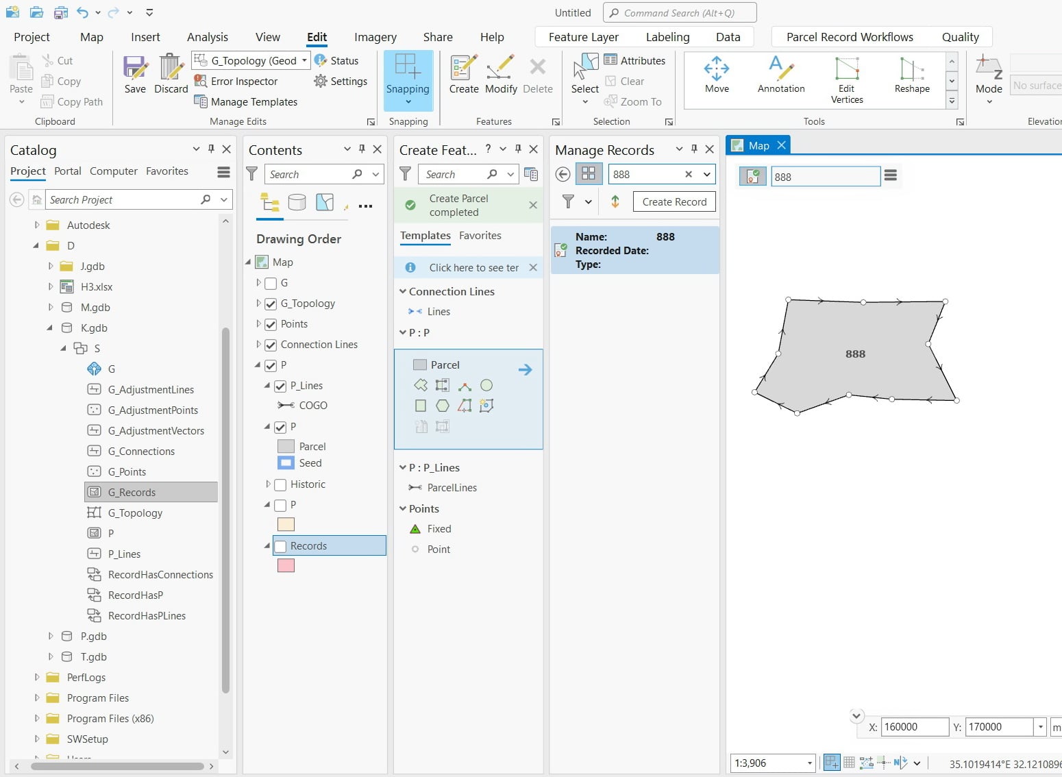

For example, in the screenshots below, parcel#888 has the following transactions:

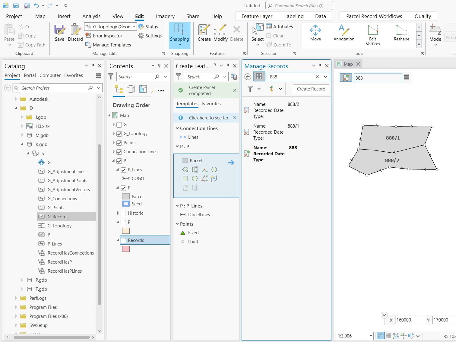

  • it is divided into two parcels: 888/1 and 888/2

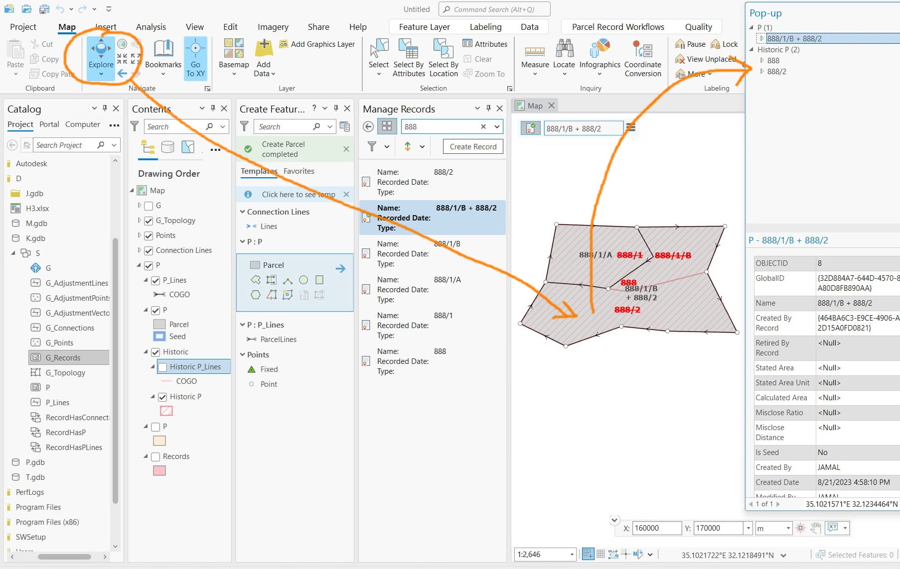

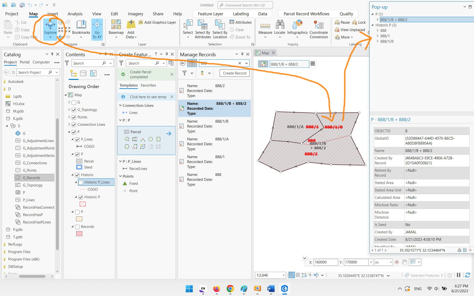

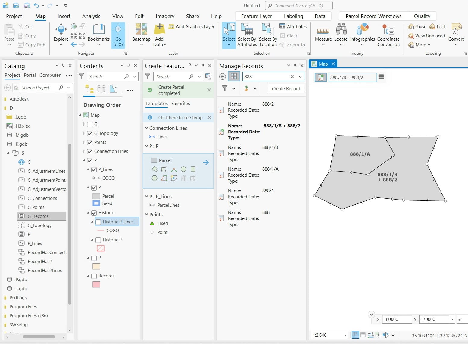

  • parcel 888/1/B is merged with 888/2 to form 888/1/B + 888/2
Now as the parcel 888/1/B + 888/2 is identified, it provides different history depending on where we click.
What could be the best practice to display the tree of the history  of parcel888/1/B + 888/2?

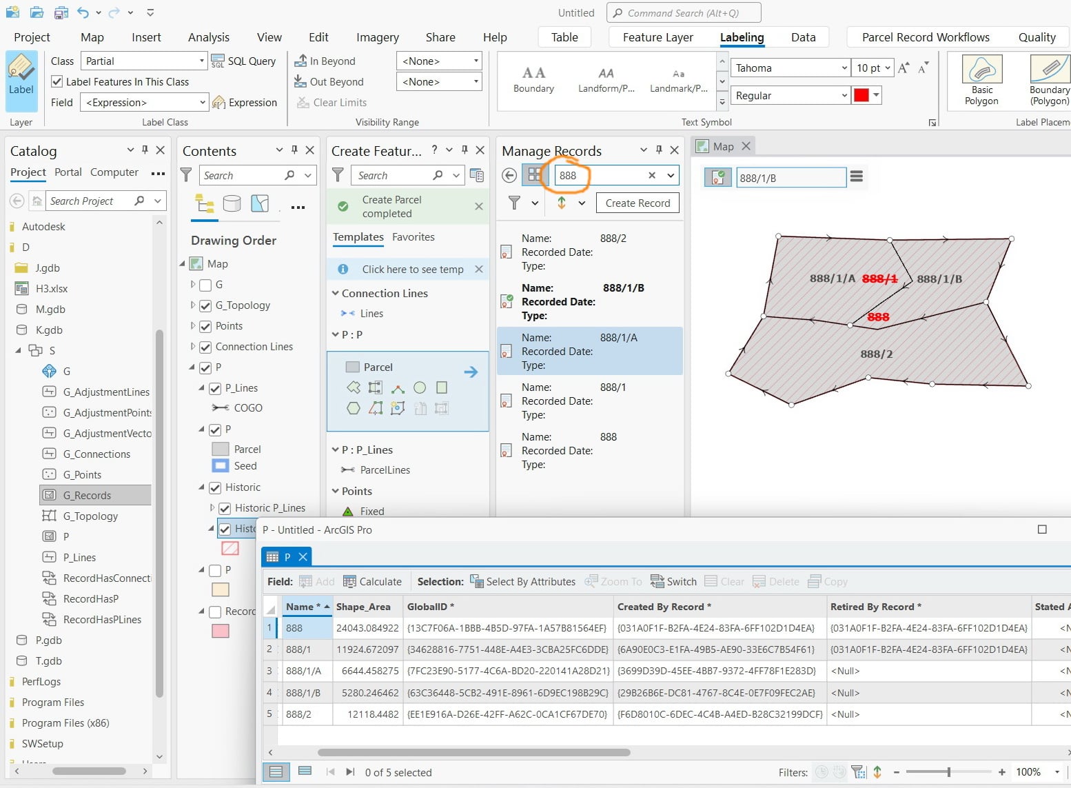

As per the screenshot below, I tried to plot the history, but the tree doesn’t appear as expected
The test data is attached

Looking at your data it looks like you forgot to create records.
Parcel 333 was created and retired by record 333.
Unless this is an interim parcel, we would expect a parcel to be created by one record, and retired later by another.
The same applies for parcel 333/1.
A normal workflow look like this:
  1. Record A created parcel 333
  2. Record B splits parcels 333 and retires it. It also created 2 new child parcels 333/1 and 333/2
  3. Record C ....
You can see the problem if you analyze the CreatedByRecord and RetiredByRecord fields on your parcels.
The record-driven workflows are well documented.
The link chart is showing the correct results for a broken lineage.
