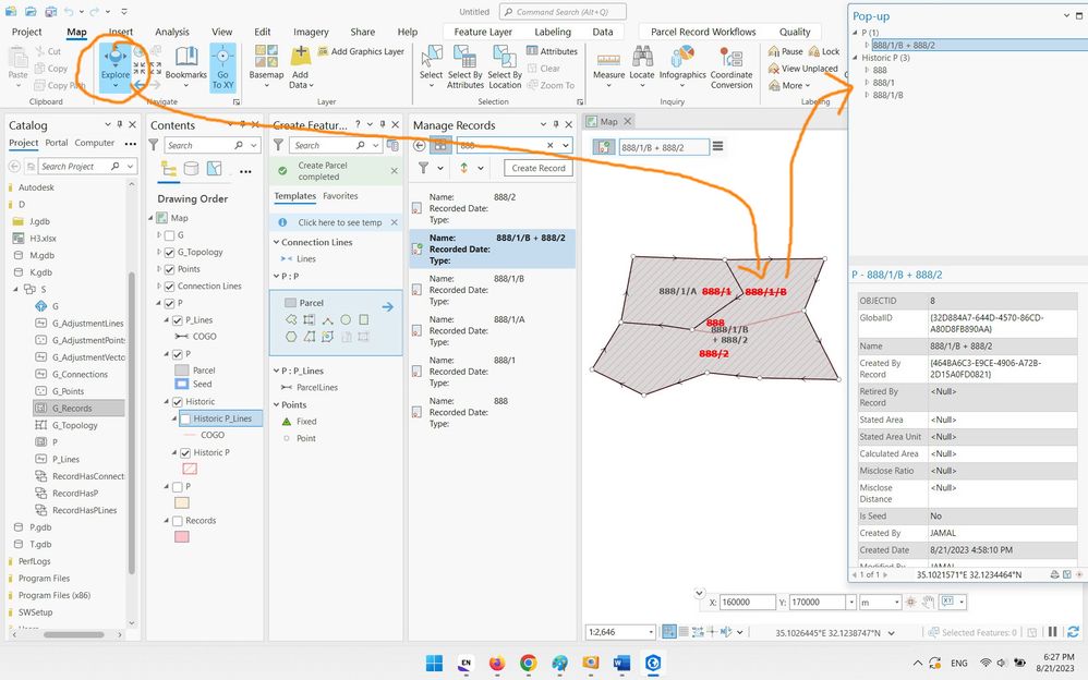

For example, in the screenshots below, parcel#888 has the following transactions:
  • it is divided into two parcels: 888/1 and 888/2
  • parcel 888/1 is divided into two parcels: 888/1/A and 888/1/B
  • parcel 888/1/B is merged with 888/2 to form 888/1/B + 888/2
Now as the parcel 888/1/B + 888/2 is identified, it provides different history depending on where we click.
What could be the best practice to display the tree of the history  of parcel888/1/B + 888/2?

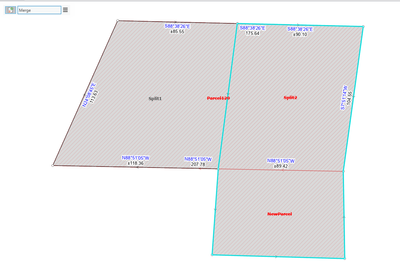

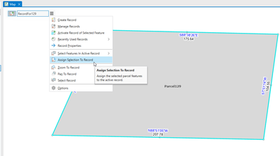

The data attached did not contain parcel 129. So I just created an approximation. Here Parcel129 is assocaited to RecordFor129. To associate a parcel to a reacord, create the record, set it as active in the map and then select the parcel and assign it to the record you created:

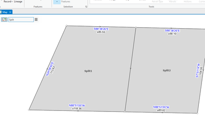

Now to split this parcel, create a new record for the split and set it as active. With the record as active, split the parcel
Now to merge one of the split parcels with another parcel - make sure that other parcel is already associated to its original record. Then create a NEW RECORD for the merge and set it as active. Perform the merge.

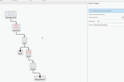

Now a lineage for the original record of parcel 129 shows this
RecordFor129 created Parcel129, which was retired by record Split. Record Split created two new parcels Split1 and Split2. Split2 was retired by record Merge, which created MergedParcel.
