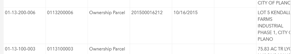

This is a totally different solution, but what we do for our parcel fabric is maintain a separate "Hosted Fabric" layer, which you can see here (or at least the "current features" view of it): https://maps.co.kendall.il.us/portal/home/item.html?id=c500c8284edd4112a9ee1a96236a72fc
There's also a separate service that collects all the boundary lines and points in a similar manner.
We then have a nightly script that checks the "real" fabric for changes, then applies them to the hosted layers.
We do this for a number of reasons.
  • hosted feature services use the server's shared instance pool, so public viewers do not impact users actively editing or working with the "real" fabric
  • through a reshaping process, the hosted features have the actual created/retired record name and recorded date, rather than simply the globalID of the records
  • our DB machine can actually cycle down for maintenance, updates, etc., with no impact to the public layers
    • we have a dedicated machine for the parcel fabric database. as a cloud machine, being able to turn it off outside of business hours represents hundreds of dollars in savings
  • extra fields can be dropped
  • the hosted layer can have extra fields not in the fabric, which get updated from our assessments database (another script)
  • hosted records layer can have attachments, to which we attach PDF "change record" documents, etc
It was a lot of work to set up, honestly, but it provides our end users with the data they really want. The updates are all automatic, so I haven't had to even think about updating the public layers in months, but they refresh every night with the latest data. It's great!
