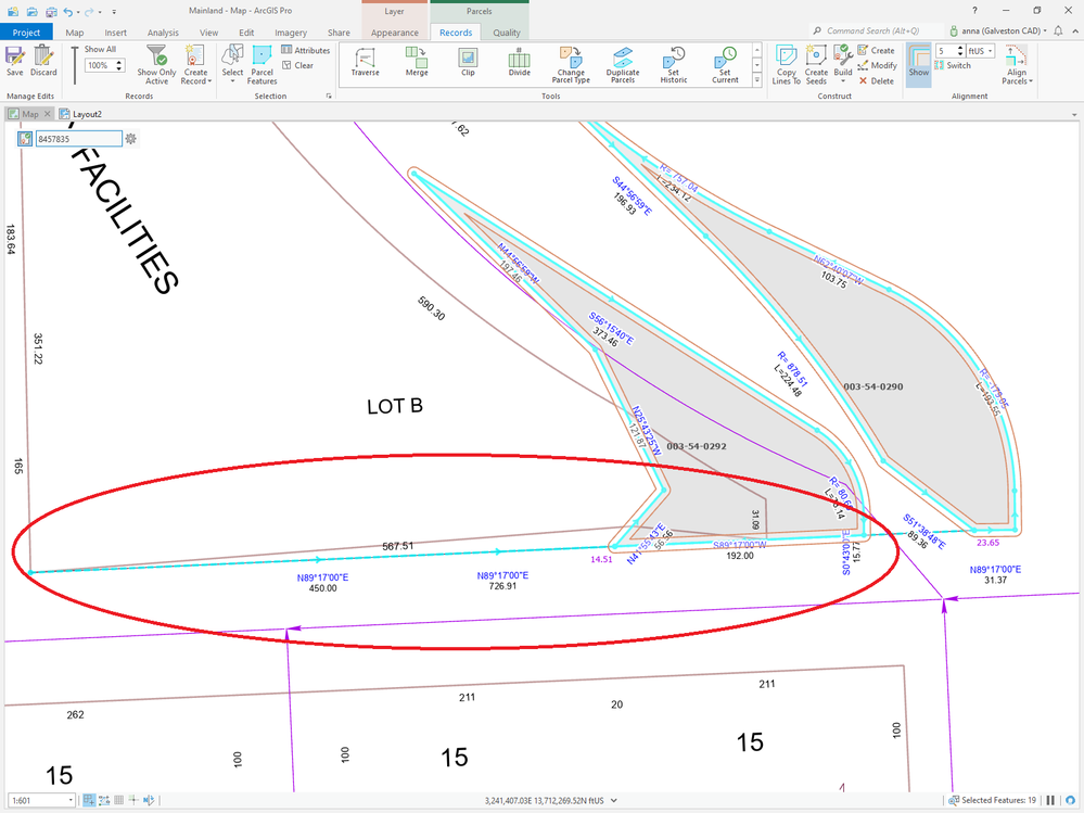

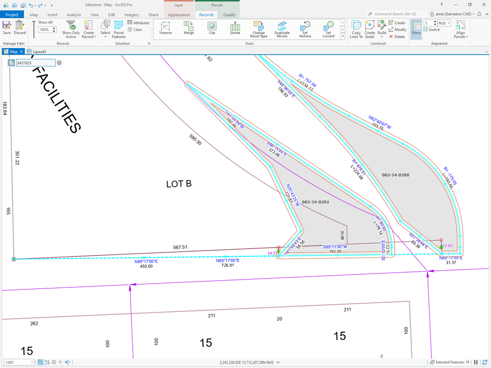

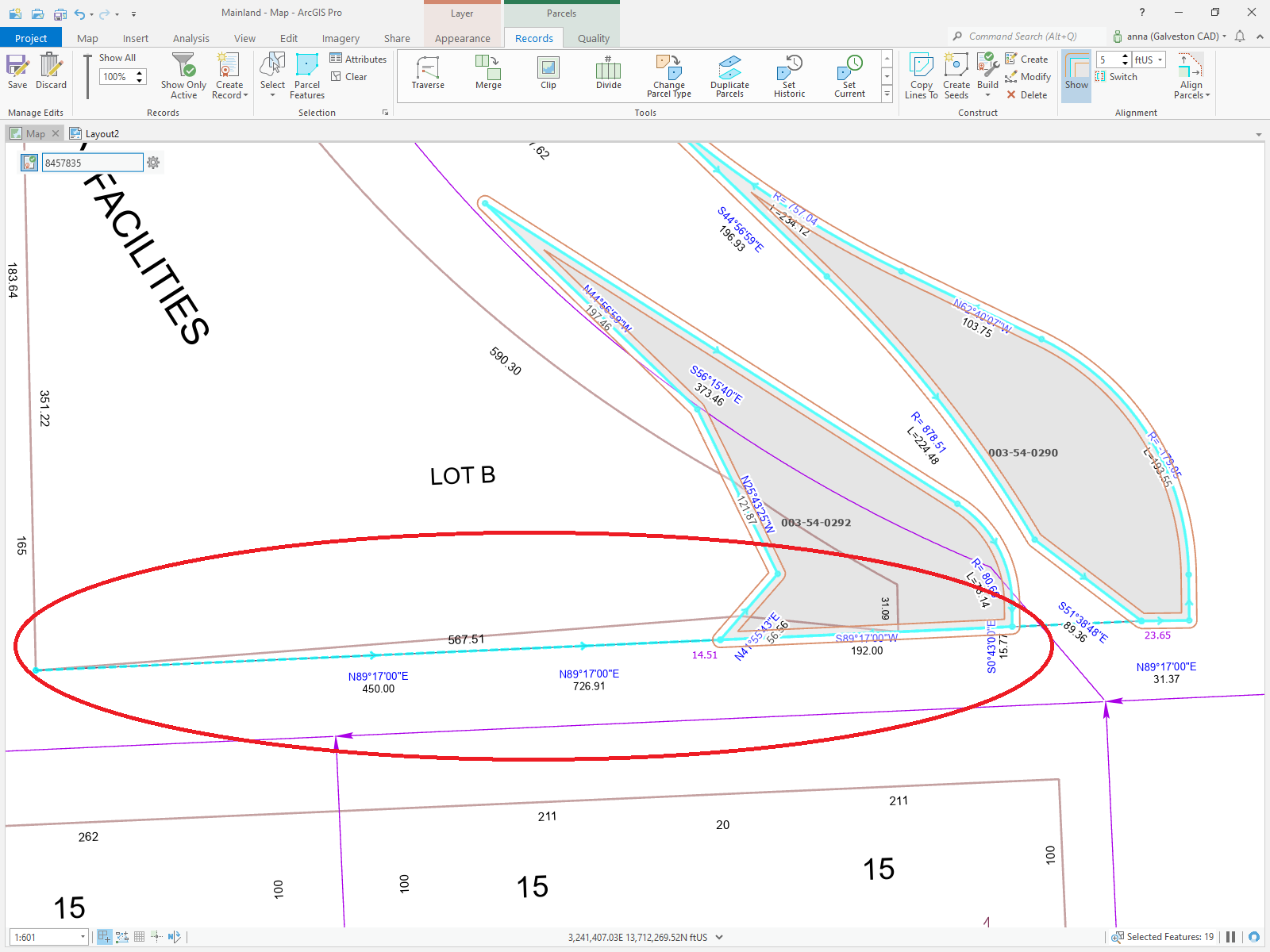

Has anyone else run into this problem? I'm attempting to align two parcels and it's affecting adjacent/overlapping parcels. The parcels being affected are not editable or selectable, and yet Align Parcels moves the boundaries.
This isn't the first time this has happened and I cannot figure out what the common denominator is that causes this issue.
Before:

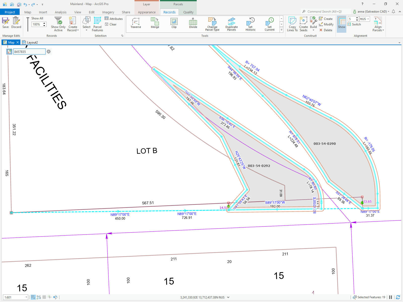

After:
I was trying to figure out a discrepancy with a street in this instance. The align parcels tool is not helping.

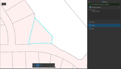

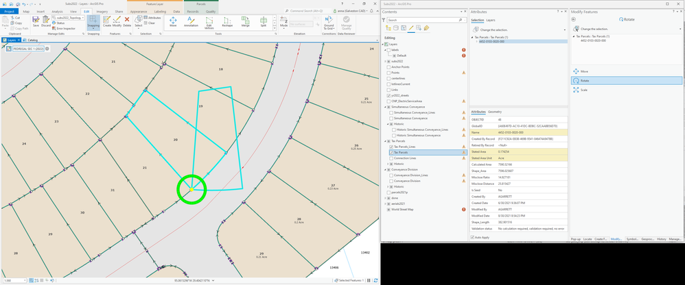

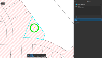

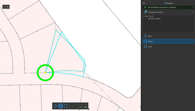

Rotate will even move historical parcels and other parcel types with the selected parcel. The dashed lines in the middle screenshot indicate topology relationships that will move with the selected parcel. If you want to move only your selected features and not those around it, you can turn topology off momentarily.

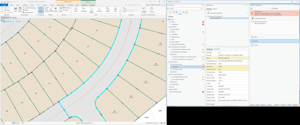

Yeah, actually. Every time I've tried to use Rotate it tells me the layer isn't editable even though it is. Where exactly is the option to turn off topology temporarily? Because I've never seen that as an option.

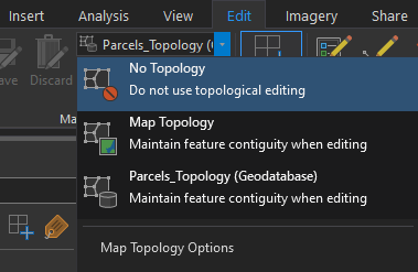

Topology can be controlled on the Edit tab under Manage Edits. There is a dropdown box.

As an experiment, I disabled editing on a different Parcel Type and tried the same edit.
I received the "Layer is not editable..." error. I think that this is because Pro wanted to adjust the other Parcel Type along with my selected parcel since they are topologically connected.
To counter this, I turned off topology, and I was then able to edit the selected feature without the error.
To me this isn't a great fix, because you'd want to have topology on in most cases, but I don't know a great way to counter this if you need to prevent a layer from being modified.
