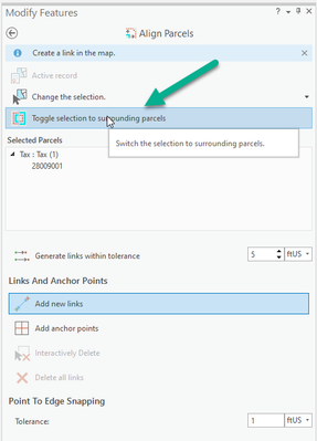

AmirBar-Maor
The selected parcels move.
To move the surrounding parcels and keep the incoming in place, the Selection toggle makes it easier to select them:
The Align Parcels in ArcGIS Pro, just the same as ArcMap, moves points.
Any point that moves, will also move and update any connected line or polygon regardless if they belong to a layer that is visible to not.
Just like ArcMap, only visible parcels participate in the alignment (or Joining).
If a parcel is far off from where it should be, the Move /  Rotate / Scale tool can be used to bring it closer.
If you think you are seeing un-expected movements please log a case with technical support.
