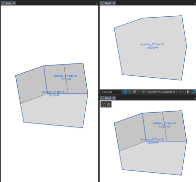

A decent workaround: if you run Copy Parcels with a parcel selected, it will still create a whole new parcel fabric with the entire schema, but will only copy the selected feature in, along with any associated records, lines, and points.
At left, a test parcel fabric. Upper right: copied fabric with selection. Lower right: copied fabric without selection.At left, a test parcel fabric. Upper right: copied fabric with selection. Lower right: copied fabric without selection.
So just select a single parcel, run Copy Parcels, then in the new parcel fabric, delete that single feature.

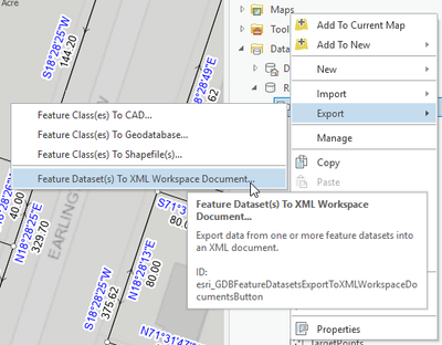

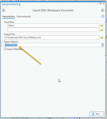

Another option, assuming you look to copy the entire schema from one environment to another, is to export and import a 'Schema only' workspace XML that is documented here.
Step 1:
Step 2: Import it
Would this work?
