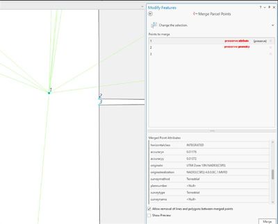

Here at LTSA we also see value in what Susan has suggested for the Merge Parcel Points tool. In our case, it is not necessarily always new points that are being creating into the parcel fabric, but existing points. Take this scenario below, with three points already in the fabric:
In this case, we want to keep the attributes from 1 and merge all points to 2 (because 2 has the oldest objectid, which is important for our publication system, and because we don't want to distort the current fabric). I see the Merge Parcel Points tool as being the most straightforward way to do this. Would you agree or do you have a different approach?

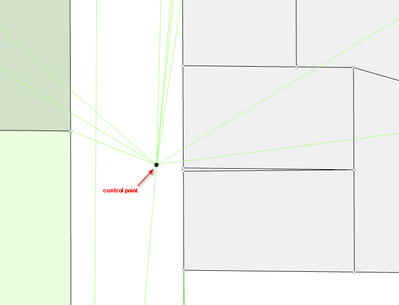

Zoomed out view, for context:
