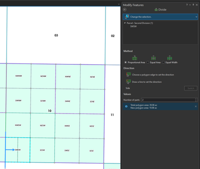

In this example I'm trying subdivide an aliquot part into 2 pieces. I have already modified my lines with the COGO data from the survey plat and I'm trying to use the divide tool to break it into 2 pieces then use the shrink to seed and reconstruct from seed tools to then align the polygons with the lines.
My parcel with the lines with the TYPE attribute set to PLSS Second Division
My divide setup

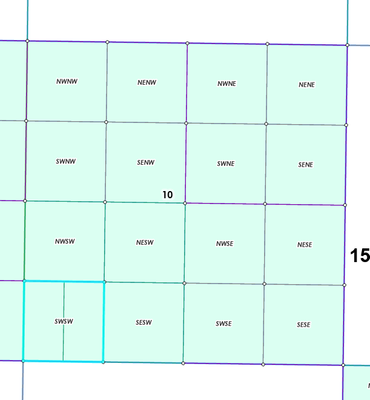

After the divide the parcels no longer show

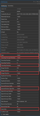

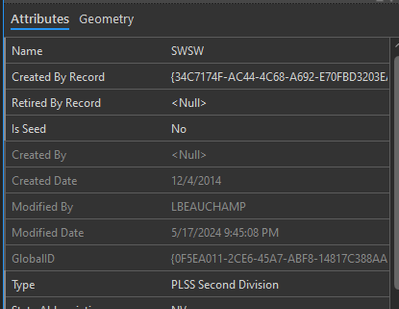

In my parcel with no definition query they are still there and now I have the historic parcel (attributed correctly and still having the type field populated) and the two divided parcels but with the type field now NULL
Historic Parcel Attributes

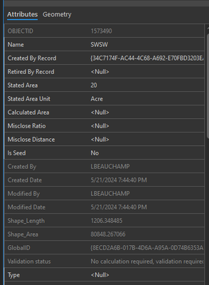

Divided parcel attributes
I actually just noticed that its many fields that lost their data but not all of them
Before Divide
After Divide

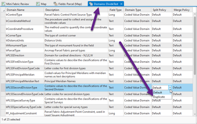

Scratch that... this is actually "by design".  I fall into this trap constantly and I wish that Domains weren't set up like this by default.  I noticed in your data all the fields that had domains were what failed to come across when Dividing.
To fix this go and edit your Domain; right click any layer --> data design --> Domains
Then find the domains you want (probably all of them) and switch the split policy from DEFAULT to DUPLICATE.  This will then fix the problem you are having.
