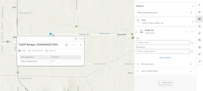

I am connected to a publicly shared AGOL layer in ArcPro (not my data). I made a publicly shared table in my AGOL and joined it to the other data set in ArcPro and published a map.
Question: Will the publicly shared AGOL layer in my published map continue to show live data as it gets updated by the owner (not me)?
This is a lookup so that the popup will display a description of a code rather than only a code. This way the user knows what the data means. I did this in ArcPro because the join will not work in AGOL.
I am trying to join the field below in this data (not mine) CULV_COND_RTNG: https://services.arcgis.com/KTcxiTD9dsQw4r7Z/arcgis/rest/services/TxDOT_Bridges/FeatureServer
to the field below in this table (my data table) CODE: https://services6.arcgis.com/eNPJk90aMrXNOKF8/arcgis/rest/services/Culvert_Condition_Lookup/FeatureS...
