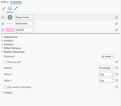

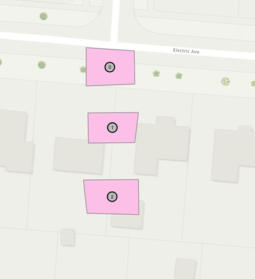

CarsonMorton
Can ArcGIS Online styles show polygons as marker points when zoomed out?
I have it working in Pro so that it has both the polygon and the point marker. So when you zoom in you see the polygon. But when I share as a web layer it dumbs down the symbology to just the polygon.

Are they in the same Symbol?
2 quick ways I think you could do this
Have the polygon layer with a marker layer with a centroid placement.  The text in the point could be static or driven by an attribute connection. Then publish to Online making sure to keep the compatible symbol option unchecked.

Or publish the map with 2 layers. One with a centroid layer and another with a polygon footprint layer.  Then set the scale ranges to how you would want them defined.

CarsonMorton
I will have to look for this compatable symbol option!
