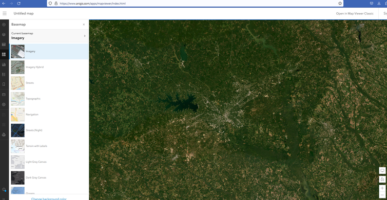

I have noticed that white grid lines are being displayed in three different sets of aerial photography when using AGOL. These lines are not visible in ArcGIS Pro 2.9. Has anyone else seen this. The lines change in size when zooming in or out it appears.

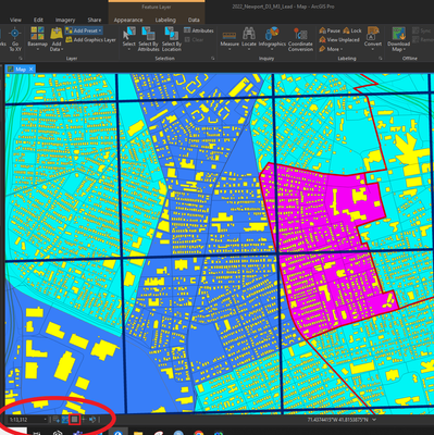

Do you have the Graticule or Grid Line icon selected? It's located at the lower left corner of your Map in ArcGIS Pro.

This was not turned on. The issue is in AGOL, not Pro.

The zoom of the browser seemed to correct this issue. I was able to duplicate it in both Chrome and Edge. If you go higher or lower than 100 percent zoom the lines show up.

That was firefox (up to date) 109.0.1 (64-bit
It looks fine in chrome and edge too even after changing the zoom percent in the web browsers.
Chrome is up to date Version 110.0.5481.78 (Official Build) (64-bit)
Microsoft Edge is up to date. Version 109.0.1518.78 (Official build) (64-bit)
