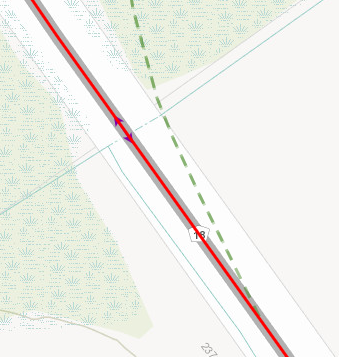

Is it possible in arcgis online to weight certain features to ensure they display over other features within the same feature layer?  I have bridges and roads within the same linework and am looking to display the bridges over top of the roads but in some cases they are hidden underneath. See photo below, the purple arrows under the red line indicate the bridge.

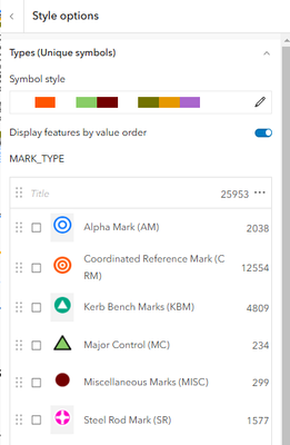

Update, I just looked around in AGOL and found that you can turn on the 'Display features by value order' to achieve this.
Drag the symbol to the desired order and when you turn the option on, the symbols should display accordingly in the webmap.
