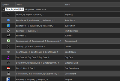

Hi Russ - I'm having a similar issue that I can't seem to resolve. When I publish out a service from Pro 3.1 to Enterprise Portal 11.1, the symbology is grouped together:

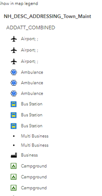

But when using the same layer in a webmap, the items are ungrouped and show 3 times:
Any help would be greatly appreciated!

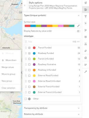

Went back to double check ent versions. This looks like  it was pulled into 11.2 version of MV where you can use Pro maps authored with the grouped values or use MV do to this.
