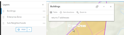

I just tested this with my data and got the expected return value (this is using an Arcade element).
var fs_parcels = FeatureSetByName($map, "Enterprise Zone", ['*'])
var targ_parcel = First(Intersects(fs_parcels, $feature))
var fs_addr_pts = FeatureSetByName($map, "Sub-Neighborhoods",['*'])
var parcel_addrs = Intersects(fs_addr_pts, targ_parcel)
var output = "returns " + count(parcel_addrs) + " addresses"
return {
	type : 'text',
	text : output

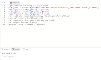

completely bizarre - here's the screen shot from running this using the First function and then one removing that function. I feel like I'm missing something really silly here.

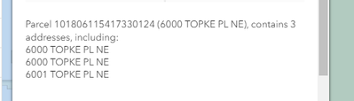

well see? something ridiculously silly. @KenBuja thanks for the assist!
code works, i have a little to do to clean it up and add some finesse stuff but the main functionality is there.
