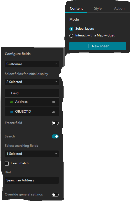

I am trying to use a view layer owned by another user in my organization. The original layer's settings allow geometry and attribute updates. The view layer is set to "Update Attributes Only". The original layer is shared with the organization and specific groups. The view layer is shared the same way.
I am trying to edit attributes of the view layer in Experience Builder using a table widget. However, editing is completely locked on the layer. I’m unable to update attributes on the item detail data page, in map viewer, or in Experience Builder. The option to "Enable Editing" in the layer's item properties in map viewer doesn't display either.
I have a “Professional Plus - Publisher” account type, and I own the group that the view layer is shared with. Are there any other reasons the view layer would have editing locked?
