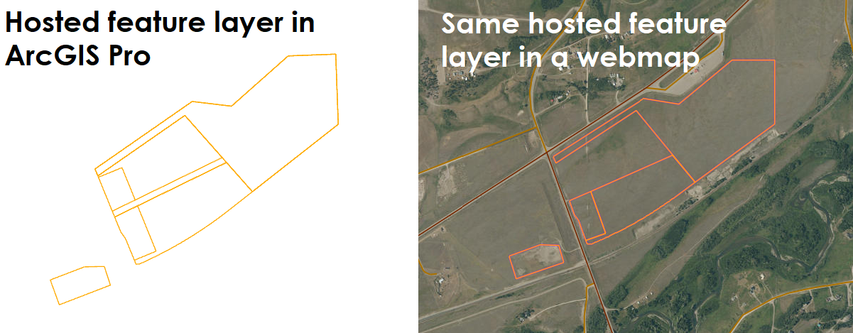

Hello,
I'm having issues when it comes to editing a hosted feature layer in ArcGIS Pro. Screenshots are included below the text.

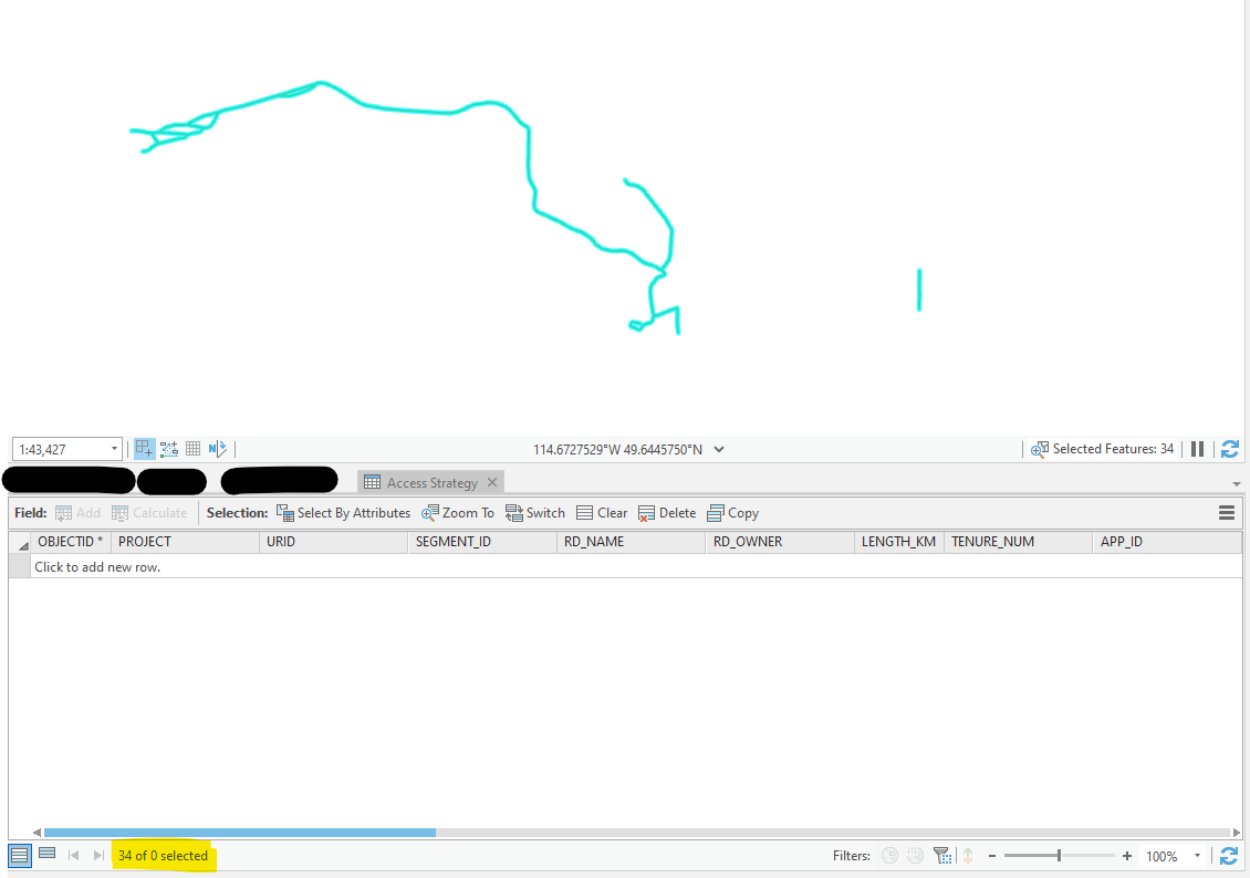

Essentially, when I make updates to some layers within a hosted feature layer, the edits will show in my map frame in ArcGIS Pro, but it won't show in that same hosted feature layer on a webmap. Additionally, despite the updates showing in my map frame, when I look at the attribute table, those records aren't even there. If I select the area where they should be, it'll say that those features are selected, but the attribute table doesn't actually show those records so they technically don't exist.

Example of the hosted feature layer displaying the update in ArcGIS Pro, but not carrying over to a webmap.
Second example where the features that have been appended are displaying fine in the map frame, yet they don't have any actual records associated with them in the attribute table and do not display in a webmap.
When selecting the visible features, the attribute table looks like this. Note the bottom left where it says, "34 of 0 selected"
