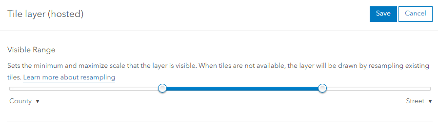

I then went to the settings of the Tile Layer. It was initially set to this:
I updated it to this:

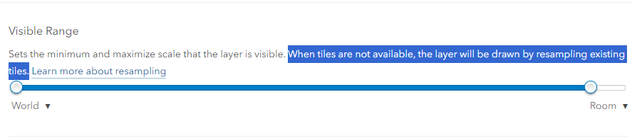

Based on the highlighted text, it would seem to me that since I have set the Visible range to larger than the tiles that were published, it would resample the closest available tile size.
Unfortunately that doesn't seem to be the case. When I opened the layer again and zoomed out, the tiled layer still disappeared, even after manually updating the layers Visible range in the map as well.

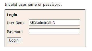

@MDB_GIS It's absolutely killing me right now! I have tried everything I can to edit that setting from the tiles.arcgis.com rest link, but I can't get past this brick wall:
Kuyler_JonesCivil
I had to simply go to https://tiles.arcgis.com/tiles/ and then enter my credentials. It will then display a services directory, where your tile layer should be listed. For some reason, I can only access the item and its settings this way. Another alternative is to enter your credentials on the item's complete URL, and then click "Home" to access the directory. For some reason, the login on the item's complete URL doesn't trigger the map server settings to load.
MDB_GIS
Do you know who your AGOL/Portal admin is? You should be able to use any login that has admin privilege to sign in.

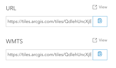

I just discovered that it works much better to load the tile layer as WMTS. If you have access to the item details page, you can simply copy the WMTS link URL.
If you are using a tile layer from another organization, you can simply add "/wmts" to the end of the MapServer URL when adding it to your map.
    ex. https://tiles.arcgis.com/tiles/{orgid}/arcgis/rest/services/{name}/MapServer/wmts
Technically, I think the URL is longer than that, but when adding it to Map Viewer, I believe it automatically completes it.
vs.
https://tiles.arcgis.com/tiles/{orgid}/arcgis/rest/services/{name}/MapServer/WMTS/1.0.0/WMTSCapabili...
I had to do this after realizing that a tile layer from another organization failed to resample in my Map Viewer, even with "resampling" : true
