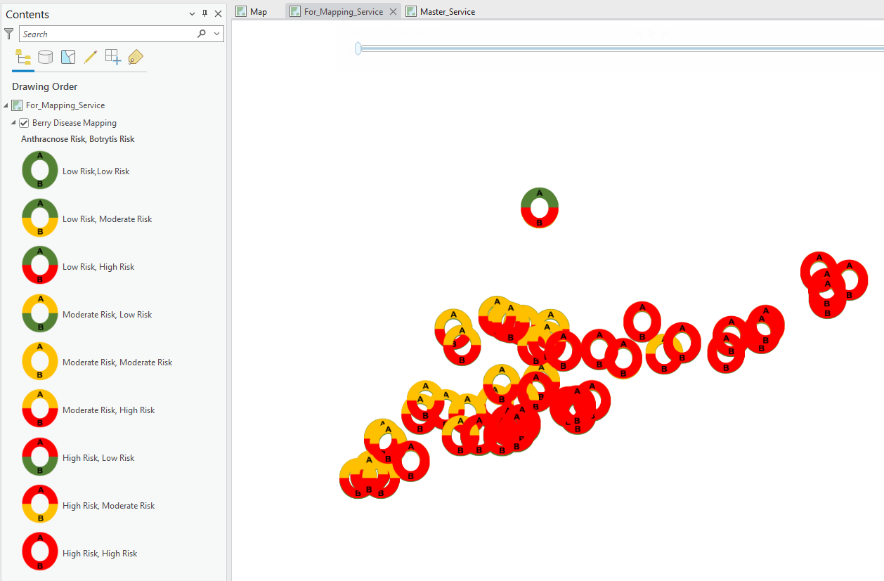

The symbology that I use in ArcGIS Pro...

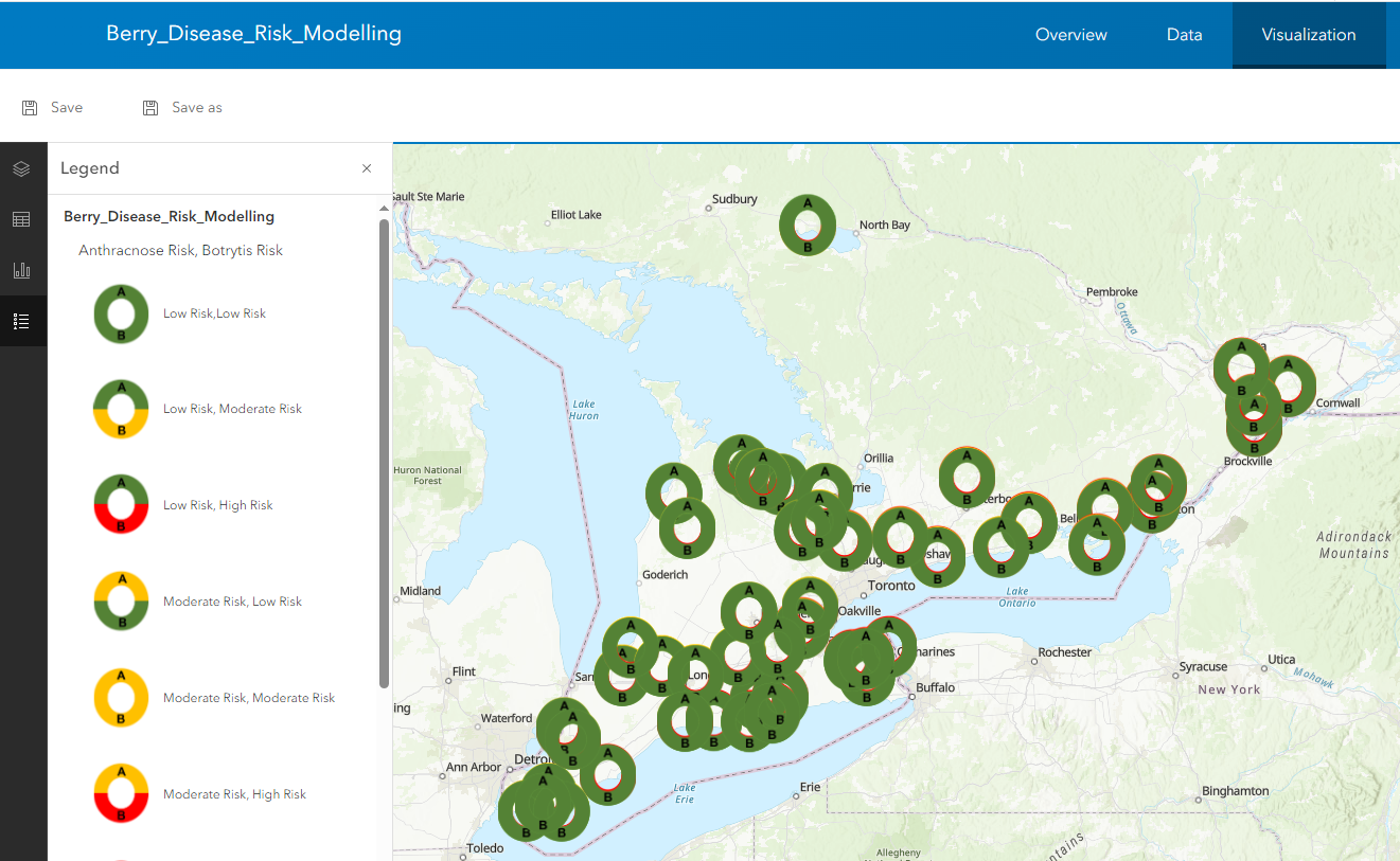

My feature service symbology, in AGOL, before my python script is run...

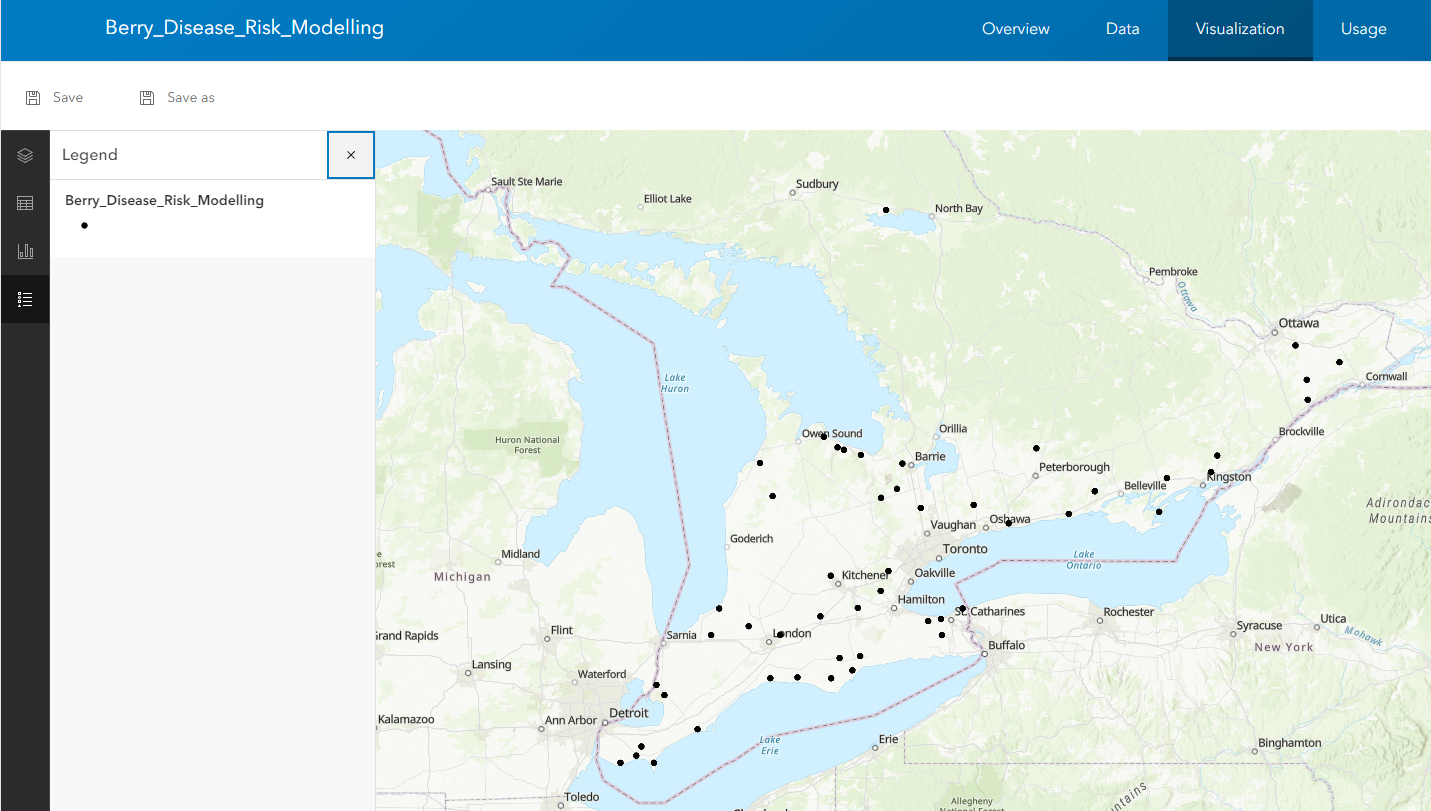

My feature service symbology after I run my script...
And when I manually overwrite the service in ArcGIS Pro, the symbology is then applied properly again.
I'm not sure what has changed that my python script no longer applies the appropriate symbology.
