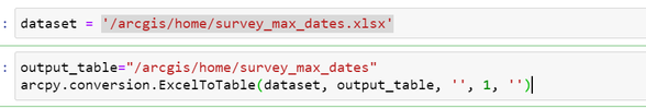

Hello,
I have a Jupyter Notebook that I am attempting to use for a scheduled task in my ArcGIS Online acocunt. I have successfully run several lines of code, but I am running into an issue using arcpy in the notebook. Specifically, I am wanting to convert an excel file into a table using arcpy.conversion.ExcelToTable with the following parameters.
Note, that I am attempting to export my output table to /arcgis/home.
Is this the correct way to go about this?
Any help would be appreciated.
Thanks!
Tim_McGinnes
In order to use arcpy in an ArcGIS Online notebook you need the Advanced Notebook privilege. See here under General Privileges\Premium Content: https://doc.arcgis.com/en/arcgis-online/reference/roles.htm
Arcpy in ArcGIS Online notebooks only has a very limited set of modules available. The only reference as to what is included I could find is here: https://doc.arcgis.com/en/arcgis-online/reference/use-arcpy-in-your-notebook.htm
The arcpy.conversion module doesn't appear to be available according to that list? Is it giving you an error message?
by Anonymous User
Not applicable
I am currently using the advanced notebook. There is no error given, it will just run for the maximum allowed time ~20 mins and then the kernel will stop. I assume this is because the module is not supported in online yet.
