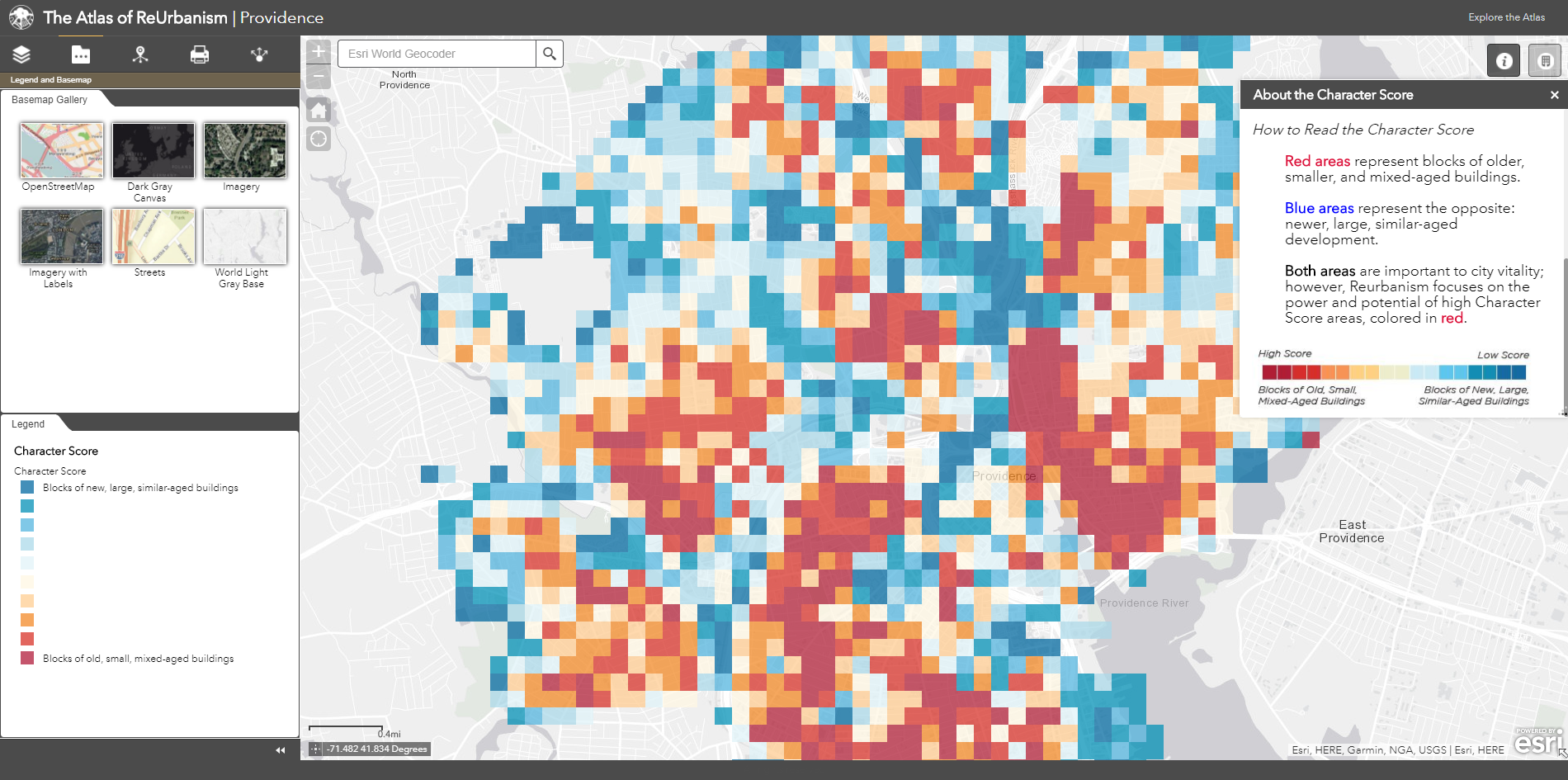

I did find a workaround. When uploading the tiles, I changed the symbology labels in ArcMap to just text, and in the web app, added an "About" widget with the legend. The widget is set up so that it's automatically opened when a user first accesses the webmap:
AdrianWelsh
MVP Honored Contributor
Nice work, I like it! Very informative and visually pleasing. (I would suggest marking your response as 'correct answer' to close out this thread).
