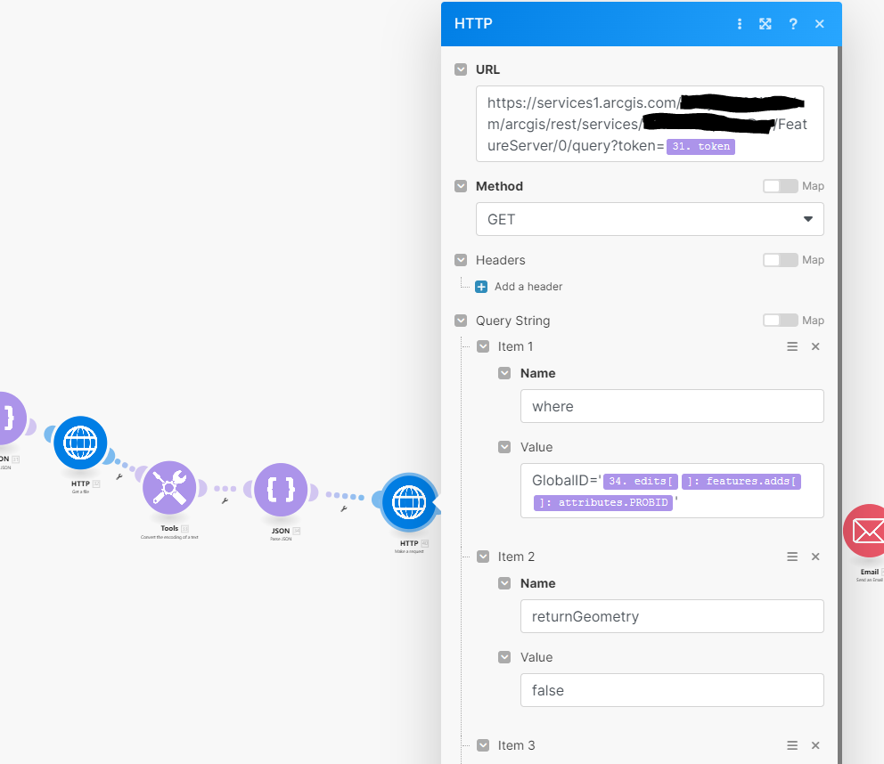

The first issue I am running into is that I cannot seem to query the 'parent feature' in the HTTP 'make a request' module. I cannot get the 'where' query to work, unless I hard code the value. It seems like I am missing something simple over here, but cannot figure out what?

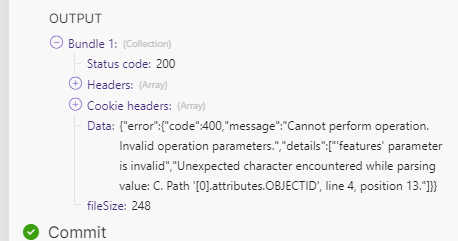

If I hard code the value for 'GlobalID' then the 'where' query in 'Make a request' module works as expected. However, when I try to update feature using POST method, I am getting the following error:
I would very much appreciate any suggestions/ideas.

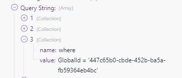

If I hard code the Globalid this is what query looks like, and the output returns just that record, as expected
If my 'where' statement is 1=1, it return all records, as expected

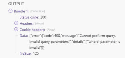

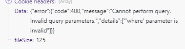

But if I add a variable for my 'where' statement, GlobalId = 'global id from related table' (I tried double quotes, single quotes, no quote), the query shows nothing for global id, and I am getting error in output

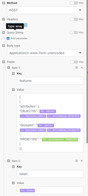

This is what I have for my POST configuration
