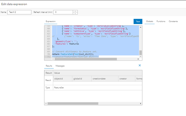

I have tried this one:
As far I can see I only populate data from the fs1 featurelayer, and it should show the data, but the result is an empty dictionary. And it contains data.
Can you see something wrong in the code?
If not I can try and share the layers.

The result is an empty dictionary:
