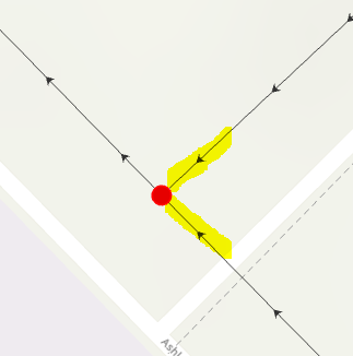

Hi there,
In the process of trying to return field from line geometry inside of attribute rule for point geometry. For visual reference I want to return the Max Downstream Invert value of the two highlighted lines (mains) intersecting with the point (manhole) to the point feature, ignoring the third main that intersects at starting vertex instead of the end.
I am able to collect data from a point, populate line geometry with that information, and use Geometry functions to call which end is intersecting with the point. Has anyone had success doing the reverse or have thoughts on how to call geometry path of a line within point features?

KenBuja
MVP Esteemed Contributor
The variable highpipeelev is a FeatureSet, but Geometry requires a Feature.
var highpipeelev = First(FeatureSetByName($datastore, "SewerLine", ["DOWNSTREAMINVERT"], true));
