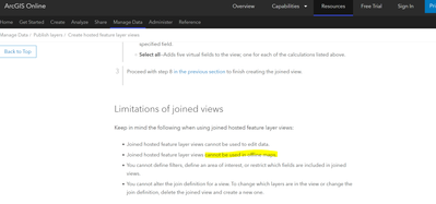

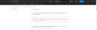

I found this: Manage hosted feature layer editing—ArcGIS Online Help | Documentation where it is stated "You cannot enable editing or synchronization on hosted feature layer views created as a result of running the Join Features tool."
But I really need to take a Layer Offline which must be a view between 2 Hosted Features. Is there a way to create such a View without using the Join Feature tool?
Thanks you very much for any suggestions!!
