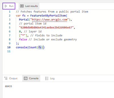

You can trouble-shoot by using the Console function and opening the Console tab after clicking "Run"

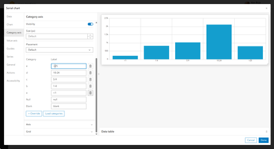

The code would sometimes not run due to the bin names. If I changed them to this, it would run consistently
var bins = {
  "a": 0,
  "b": 0,
  "c": 0,
  "d": 0,
  "e": 0
for (var f in fs) {
  var acres = f["Taxlot_Acres"];
  if (IsEmpty(acres)) continue;
  When(
    acres < 1, bins["a"] += 1,
    acres < 5, bins["b"] += 1,
    acres < 10, bins["c"] += 1,
    acres < 24, bins["d"] += 1,
    bins["e"] += 1
Then you would add the proper column names in the settings
