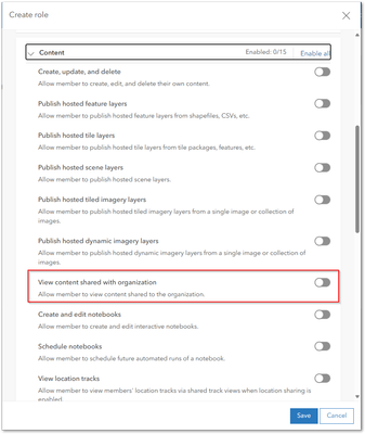

Create a group and share only that one app, and add the user.  This will limit that user to that one app.
As for the data in the app, you will have to share it with the group too.
Create a custom role that has permission to see only the content shared with groups and not items shared with the organization.  This prevents them from seeing anything not explicitly shared with their groups.
