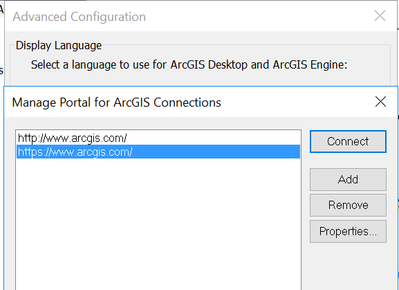

For me, the issue of sign in to ArcGIS Online only happened in Qa and Prod Servers.
The dev server was fine.
Turns out ArcGIS Administrator>Advanced>Manage Portal Connections was only pointing to http://www.arcgis.com/
So, I added AND connected https://www.arcgis.com/ and it worked.
Add the ArcGIS Online organizational domain in ArcGIS Administrator
https://support.esri.com/en/technical-article/000013176
Maybe the server internet options/proxy whitelist only allowed https arcgis urls in the higher environments (qa/prod) to be more secure.
I also added the appropriate Esri urls to the trusted sites.
