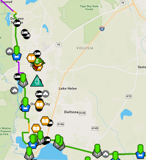

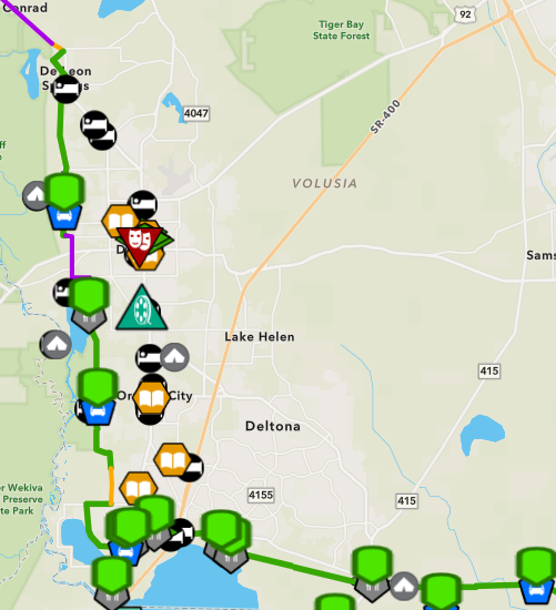

I'm having some issues with some symbology when uploading to our online portal.
I've created a map and some custom symbology in ArcGIS Pro. After uploading it to ArcGIS Online, sometimes the symbology gets messed up.
Here's what the map looks like in Pro:
And here's what it looks like in Online:
I've saved each of the custom symbols as a style and that seems to help (at least some of the time), but it's not fool poof.

I realize I forgot to mention the intent.
I'm sharing the map from Pro to Online to use it in an Experience Builder app.
The screenshot with the wonky symbology is from the Map Viewer.  The map widget in the Experience Builder app displays in the same stretched manner .
