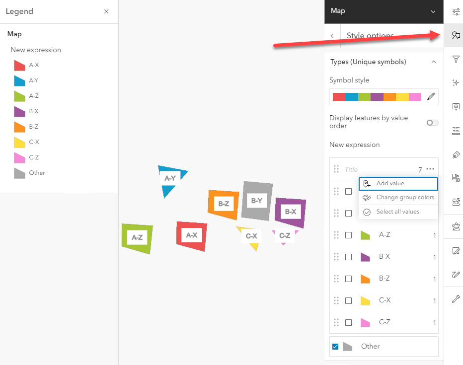

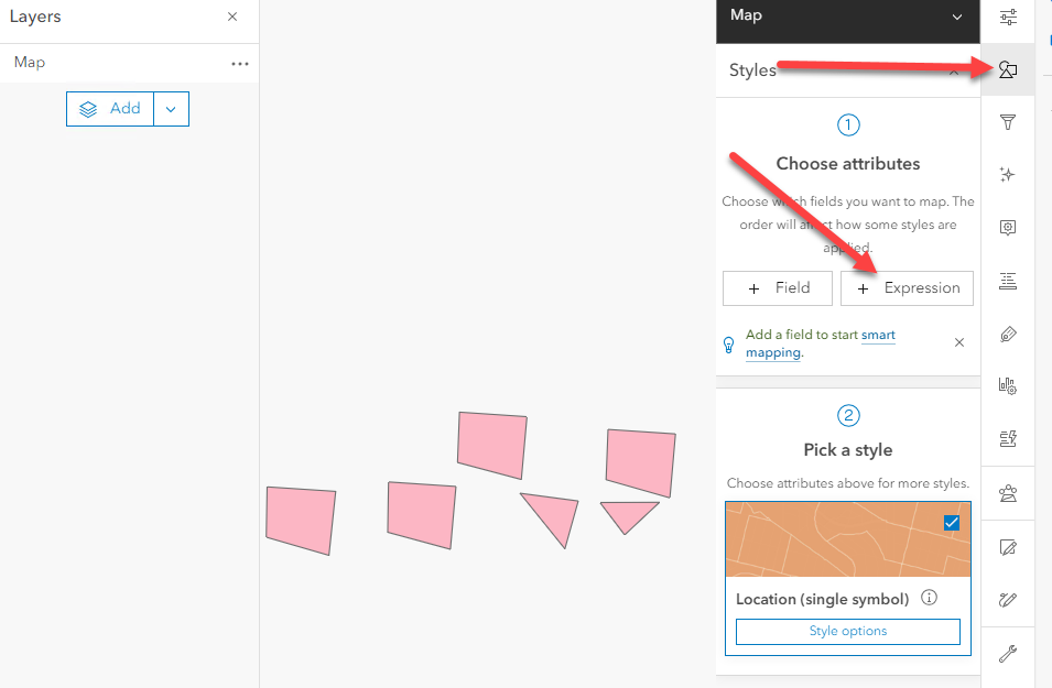

In Map viewer symbology, click Expression:
I used:
var SD = DomainName($feature, "Status")
var FD = DomainName($feature, "Funding_Source")
return Concatenate(SD,'-',FD)
Which, since I already had several of the combinations in the data, it automatically sets up those class values.

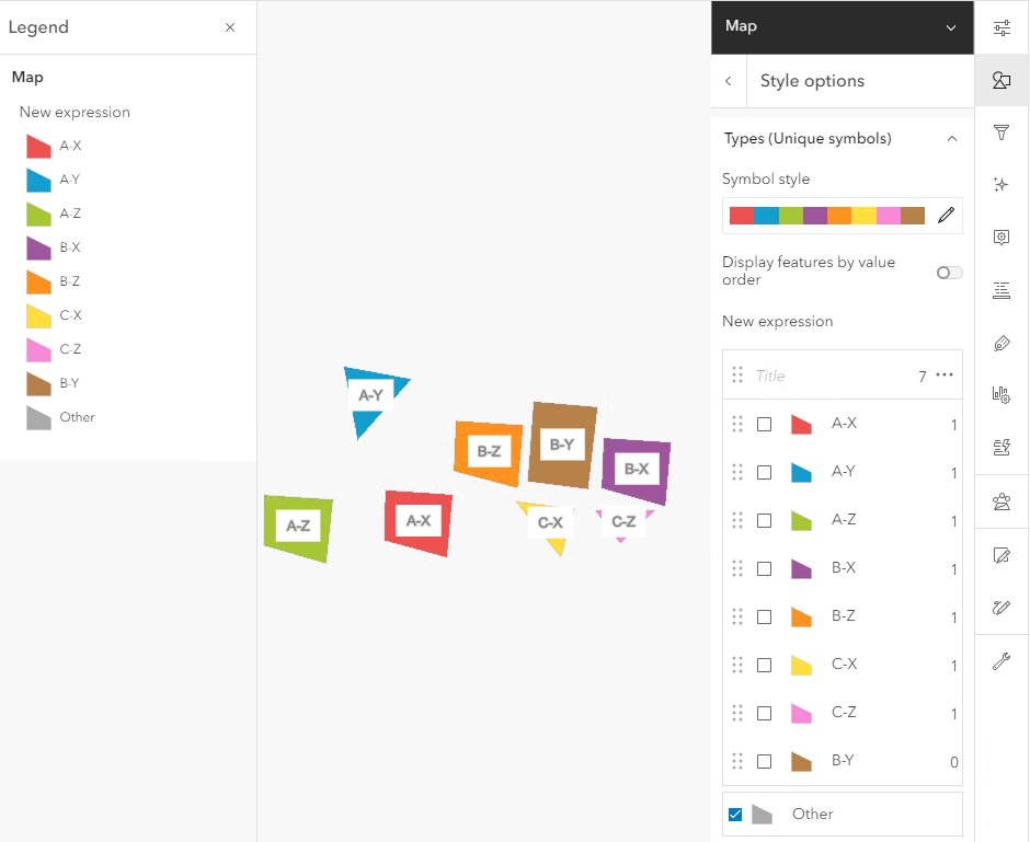

Then, I added a new polygon "B-Y" since it wasn't already in the list, but it symbolizes by "Other".
Then, select the three dots and Add Value:
And enter the value(s) you want (here I add the missing "B-Y")
And it now symbolizes by the newly added value instead of "Other".
