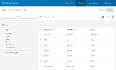

The structure and logic page is very helpful.You can check a field type in the Data tab of the item's page in your Content.
