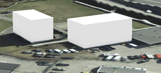

I have a multipatch layer, whose elevation settings are set on the ground. I want to convert it to a feature class using "Layer 3D To Feature Class". When I use the geoprocessing tool, it correctly generates an output. However, when I run the tool through Python, it generates an empty output.
The multipatch features:
