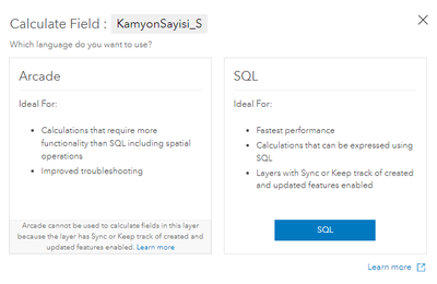

Hi, I could try it in ArcGIS pro but not AGOL, because it says;

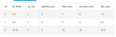

It won't be pretty, but using AGOL's subset of allowable SQL functions, you can try something like this:
((SUBSTRING(str_field, 1, (CHAR_LENGTH(str_field) - POSITION('-', str_field)))) + (SUBSTRING(str_field, (POSITION('-', str_field) + 1), 100))) / 2
I don't have an AGOL layer to fully test this on, but here's a DB Fiddle that's pretty close, though the POSITION function follows a different syntax:
https://www.db-fiddle.com/f/bJkJyB5dy4jNvVA5Qz6aHo/0
