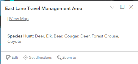

Hello,
So I have a table with URL links if a specific boundary has a PDF map available for folks to download. I created an arcade expression to add the HTML link. Not all boundaries have a URL so needed some logic to return nothing if there is no URL. However, there are two square brackets that are showing up and I have no idea why.
The pop-up:
The code:

KenBuja
MVP Esteemed Contributor
You are instantiating links as an array (line 6) but are using it as a string. Try this
