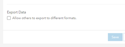

If I share a hosted feature layer to the public, but, uncheck the "Allow others to export to different formats" box in the item Details settings page, then the public can view the data, but the option to export data is not there.

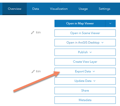

However, when I log in as a user with credentials, the full list of options show:

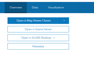

I see it still gives option to view in ArcGIS Desktop, but if you try it will fail to add data.
