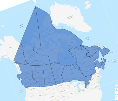

Hi Arc GIS Online community,
I am trying to map Canadian dissemination areas below, but I think the shape file coordinate system is NAD83/Statistics Canada Lambert Coordinate reference system and gives me the attached image.
2021 Census Boundary files
I appreciate  any help how to read it with Arc GIS online default WGS 1984 Web Mercator system.  I only have GIS online and QGIS.  Thanks

RussRoberts
Esri Notable Contributor
Looks like you are using the Digital Boundary version instead of the carto one. If you wanted to use that in the coordinate system. You could use this Gov Canada tile layer to have it in the same coordinate system
https://jsapi.maps.arcgis.com/home/item.html?id=3d0be59ed0fa4604b1b9384f9b9a8a36
KhoajaKhaled
Thank you Russal. I downloaded the update file and it worked.
