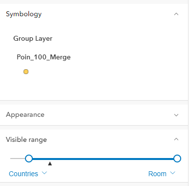

You could set the layers in a group layer in Map Viewer and use the group layer to define the visible scale range. Note this would then be for 4.x JSAPI apps that support group layers and runtime apps that also support group layers.

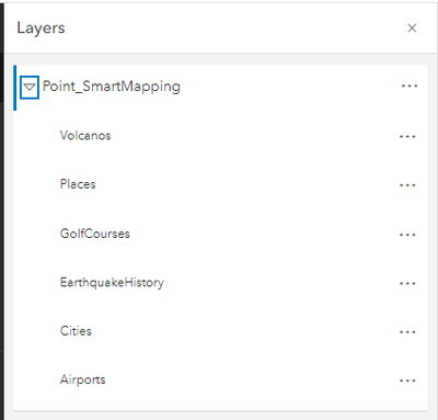

This is out now. WHen you add the item to a map it will show the item title as the group layer name and then all the layers in the item listed below.

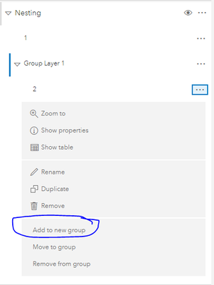

So the feature layer wont contain any nesting or in the item yet when published from Pro but we did add nesting in Map Viewer this release.  When a layer is in a group you can click Add to New group whci will create a new nested group or you can use the overflow actions on a group to Move to Group which will nest that group inside another group or drag and drop.
