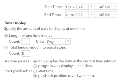

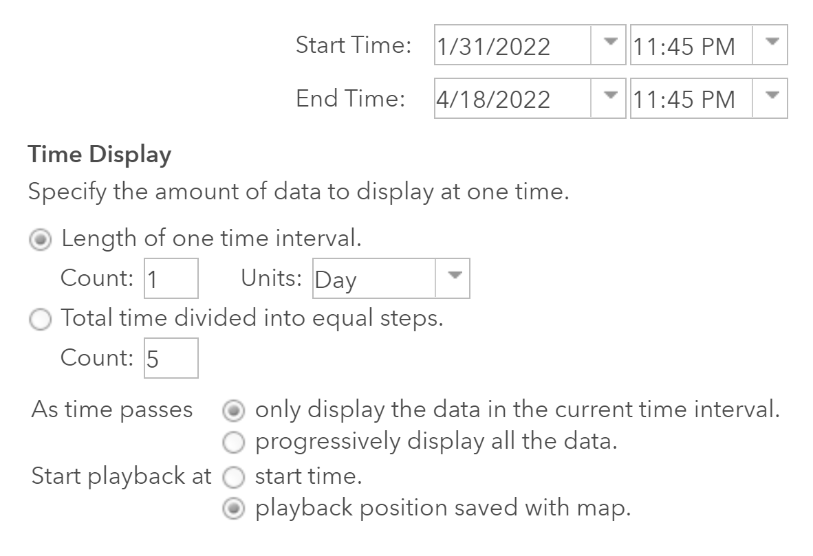

We provide image services that are updated daily with new acquisitions. We present them in web maps for users to access, and I would like to set the time slider to default to displaying the past two weeks of data. Is there a way to do that in MapViewer or MapViewer Classic?
If not, is it possible to write a script that I could run daily to update the time slider settings for each of my webmaps?
These are the settings I currently use, but I have to go in to manually set the end date:

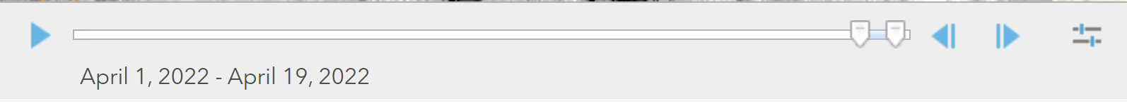

then move my two-week slider so that it's at the end of the timeline:
then save the map.

Here's an (old) post from Esri, if you have not resolved this issue: https://www.esri.com/arcgis-blog/products/arcgis-living-atlas/real-time/auto-update-time-in-web-maps...
Heidi_Kristenson
Thanks @JiaLiu1! That was really helpful! We've implemented an automated workflow based on that post.
