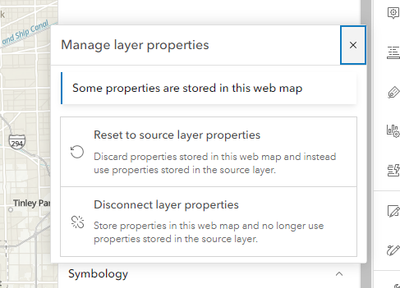

You're correct. When the map has its own symbology settings, it overrides / ignores any changes made to the default settings in the REST endpoint.
To reset your layer to take the defaults, AGOL has a button in the new map viewer.
On Portal, you'll need to edit the JSON of the map to remove its symbology settings for the layer.

On the new Map Viewer:
  1. Select the layer so that the icons on the right side are enabled
  2. Click on the Properties icon on the right side (top icon)
  3. Expand the Information drawer
  4. At the bottom of the drawer, press the Manage layer properties button to open the menu that was shown by Josh.
  5. think you then need to press the Save button a little above the Manage layer properties button to have it write to the service, but I'm not sure.
I think that should do what you're hoping...
