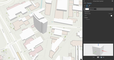

Here is a material fill I was hoping to use but the problem remains. Now I know that my replacing the building in the center with my own model somehow didn't pick up the stroke and that is why is has no outline.

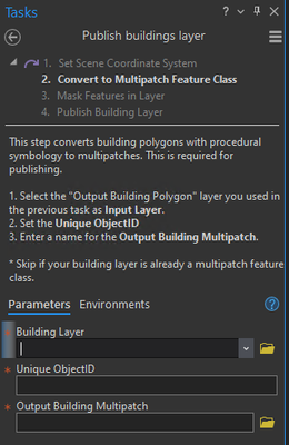

I turned off the stroke layer on my procedural rule symbology (output from solution task) and then converted to multipatch using the Publish Buildings Layer task. If possible, it might be good to have the task add a step for modifying the symbology before converting to multipatch.

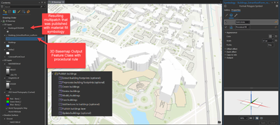

I found the project and saw the two layers in question:
Geoprocessing history says I ran Layer to 3D Feature Class on Buildings_Extract_Roof_Form to create Buildings2018LiDAR multipatch.
I see that the Publish Buildings Layer task converts multipatch to feature class; I don't know why I didn't run that instead. Would that have modified the procedural symbology to avoid the outline issue?
