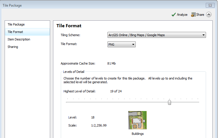

I have published a tile layer from Arc 10.6.1 successfully, and I set the tile format as follows:
However, when I open the published tile layer in a map view and start to zoom in, parts of the tile disappear at progressively higher zoom levels.

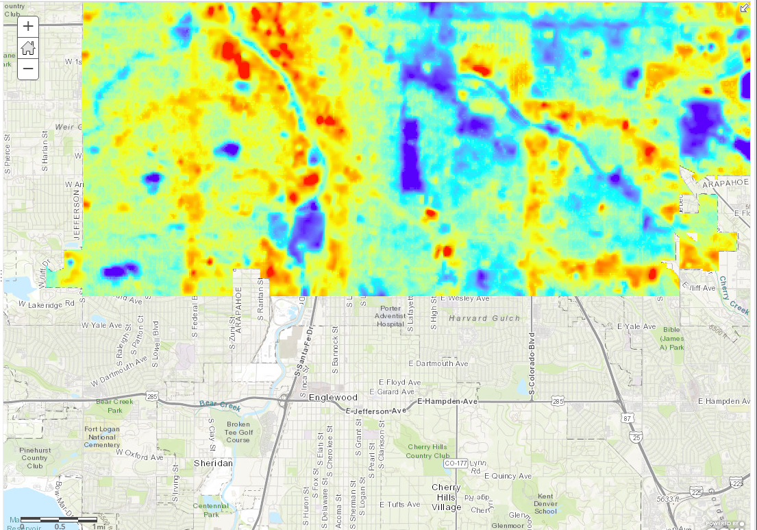

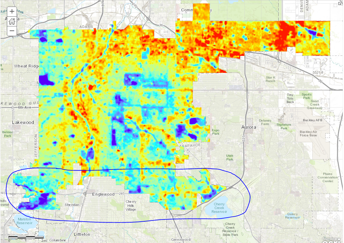

For example, here is the tile displayed at one zoom level:
And here it is at a higher zoom level, still well beyond the level 18 detail chosen above. Notice that the southern portion of the tile circled above is now cut off.
