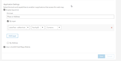

If I go to the settings of my web map details page, at the bottom, I enable search, check layer, pick my Mahnole layer and set up the query, it seems to be working as you expect.
This is with a hosted feature layer on AGOL.

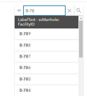

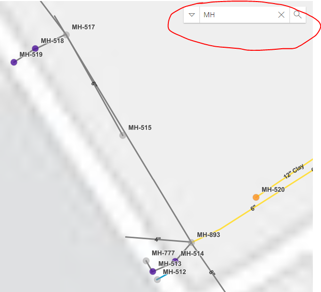

After further testing, the search widget seems to work when you type in more than 3 characters. Try the same search with less than 3 characters. For example: "89".
I've been working with ESRI Support on this, and they have determined it is a bug.
After further discussion and testing, we have agreed to report a bug regarding this issue. The bug details as follows:
  • Bug Number: BUG-000149391
  • Synopsis: Map Viewer search tool no longer returns suggestions if the entered keywords are less than 3 letters
Status: In Review
